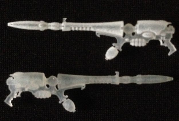

So, I was annoyed by bitz shops always being out of stock of the weapons I wanted, and decided to 3d print the heat lances I wanted instead. I took some measurements, designed the model in Blender, and printed it at Shapeways.
The result
It came out pretty well:
3d printed heat lances Printe10
This was with their Frosted Ultra Detail plastic, which I believe is printed by using a UV laser to cure wax. Aside from being a really cool image, this process seems able to remove the layering which is often seen with the additive manufacturing style of 3d printing. I was pretty impressed with the amount of detail that it holds; I was even able to model a bore in the muzzle, so I wouldn't have to drill out the barrel!
I did make just a couple of minor changes to the traditional heat lance design - most noticeably, I did away with the whipper-snipper grip, in favour of a pistol grip. While I prefer it this way, it also has the advantage that when magnetising, only the right arm needs to be magnetised; the left arm that crooks the weapon can be used for the heat lance as well as the shardcarbine, blaster or whatever.
So, with these in hand, I set about putting them in my models' hands!
Working with the material
The Frosted Ultra Detail plastic is quite brittle. While it should be tough enough for gaming use, it means that rather than cutting it with a knife, you are using a knife to snap parts off. Naturally, for me, this meant snapping off the pistol grip (I included it on the off chance I would want to have one on a rack, or carried but not wielded) to replace with a Kabalite rifle holding arm and hand.
I also found that despite their being no mould lines (cheers), there were still some artifacts from the manufacturing process Crying or Very sad. On the bright side, the material responds well to filing, so these should be simple to remove. I didn't remove them, because I was slightly deceived by the translucency of the printed models; in the end however I could see them through the paint. Oh well! They're still more than passable at tabletop standard, and not all of the prints I received had artifacts, but next time I would definitely file them back.
