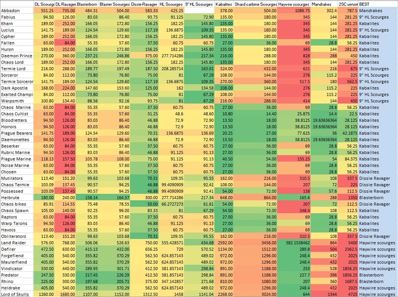

This probably looks messy, but I had a chart done up to see how best to kill my buddy's chaos marines, measured by how many points it takes to kill each unit for a set loadout. It doesn't like fnp much but it's mostly right. Dissie ravagers are great against low T multi wounds

Looking at this again, are you factoring in some kind of kill coefficient or cost analysis in there? I'm not sure I follow the numbers presented.

The way I did it up, it's how many points of a unit loadout it takes to kill one model, like it takes 27 points of kabalites (rifles) to kill one marine, but 84 points of a ravager with dark lances.
The formula is basically cost of unit divided by ( shots * to hit * to wound * save)
Example 5 kabs
30/(10*2/3*1/2*1/3)=27
Thing's like multi damage and mortal wounds are factored in where appropriate
Sent from Topic'it App

And I can factor in rerolls, but not until I'm at my computer next

Wouldn't unsaved wounds be a better indicator of damage done for cost? That sounds like an awfully complex way of evaluating a unit.
Did you come up with this yourself?

@HERO wrote:
Example 5 kabs
... lol
Yeah I know it's a bit complex. I came up with it after seeing people compare things like two dissies versus three dark lances and which one killed better, because they then cost the same. I just wanted to account for the model(s) that they're attached to as well.

@HERO wrote:
@Hen Tai, the tentacle guy wrote:
Have you tried to factor in an archon buff?
I'm also interested in this as well.
We should assuming re-roll 1s to Hit with Archon and without, as well as re-roll 1s to Wound with Living Muse Archon.
I ran these numbers and in general the efficiency changed to be better but the best option didn't change much. Notably, blasterborn start beating out scourges because of the kabal keyword. Same with the ravager. Blaster scourges only cost 5 pts more than blaster trueborn, and with their mobility and invuln it seems a no brainer, but if the trueborn are on foot with the archon nearby, they're 20% better damage wise with rr to hit, 40% with rr to wound too.
Numbers
